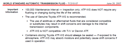

Toyota Technical Service Bulletin, June 28, 2007 - TC010-07
CQFD ?
